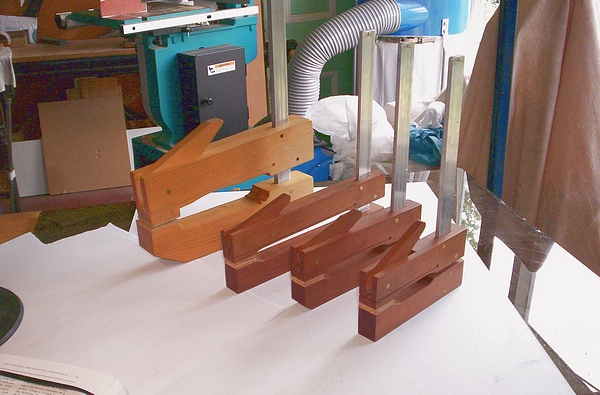

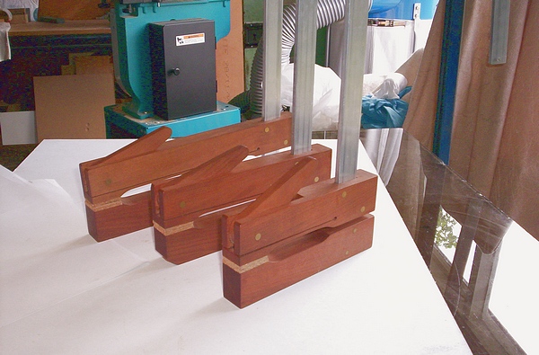

I, like many others, have made them.......... $12 is incredibly cheap !
CRAIG LAWRENCE of AUSTRALIA
PostPosted: Wed Apr 11, 2007 11:11 am
Yes, but you have the prettiest ones I have seen, Craig!

Many thanks guys. I also made a big mother ,I call Jumbo. It has a 36" bar and I use it frequently . Handy for all sorts of jobs !
I "tune " the flap part by thinning it out so that the jaws have a more parallel grip

Hesh, except for 'Jumbo' . they are made from deep red Tasmanian Myrtle , which is related to Euro Beech . The wood is ideal

Dam that edit button !!   I meant to also say that a very,very,very,very small amount of violin resin on the cam is helpful . Too much and it will be sticky ( you can wipe off any excess )

I agree with Todd, The best option is to buy them, but be careful, as others have stated, some simply don't work. An aluminium (rather than steel )bar works best as it cuts down on weight considerably .
The dozen or so I made took me quite some time to make ,but as I enjoy designing and making things I don't mind. It's called Fun !
I just designed and made a guitar stand . It was fun also , and works better than any I could buy.
Anthony , I have you down for 6 clamps @ $12 each . Any other takers ?
